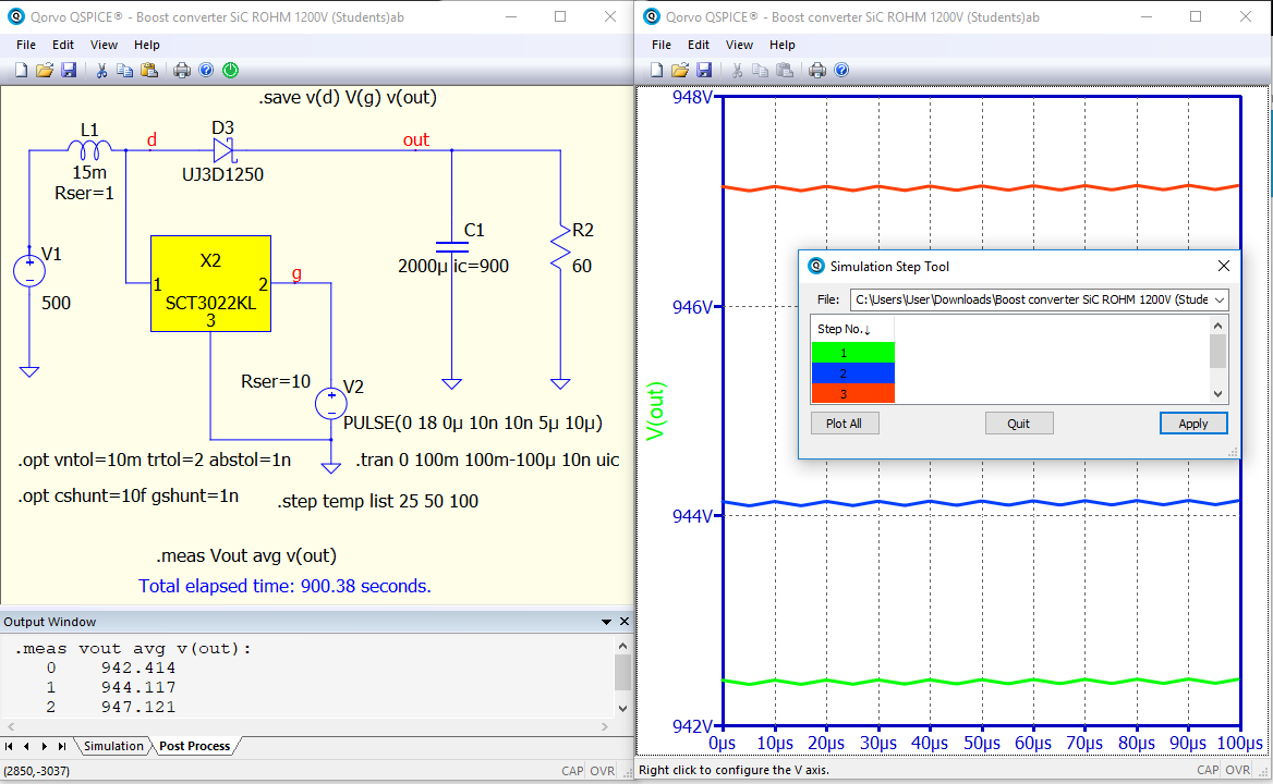

I am simulating a boost converter using a SiC MOSFET and would like to run the circuit at different temperatures to analyze the MOSFET’s switching behavior. However, the simulation is taking an excessively long time to run, and I suspect this may be due to convergence issues.
For refrence, I have attached the circuit.
Boost converter SiC ROHM 1200V (Students).qsch (7.9 KB)

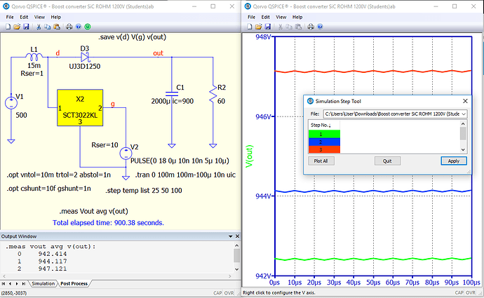

Look:
Boost converter SiC ROHM 1200V (Students)ab.qsch (7.6 KB)
Hi @bordodynov
Thank you.

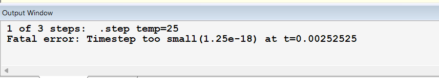

When I am running the simulation. I am still getting fatal error?
