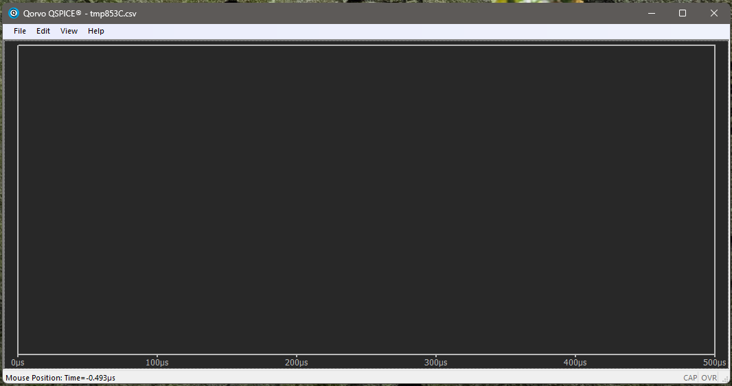

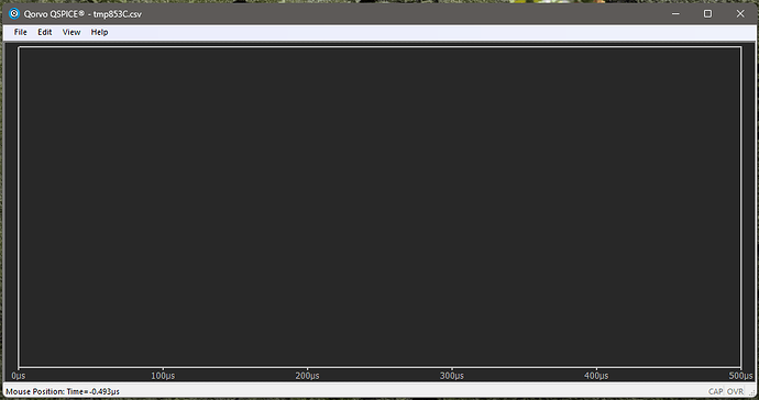

By chance, have any of you noticed in the latest released versions some issues exporting CSV data through the waveform viewer (“Export Data” from “File” menu) ?
In practice it now generates:
…without actually saving any data to a.csv file inside the folder, as was the case before.
It gives the same result for any simulation file I run.
The file goes into %temp% folder. I think it related to latest update about Test Gear. Will report this to Mike.
