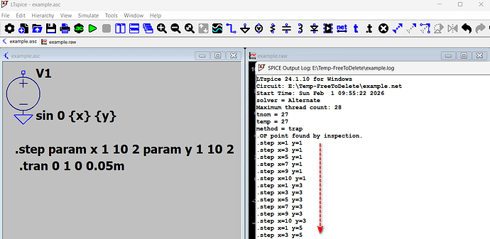

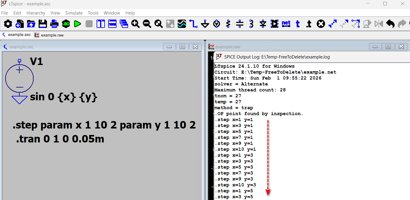

Do you mean .step runs in parallel in LTspice? My understanding is that .step is always sequential in SPICE. For example, set up this example and you can clearly see waveforms displayed one by one during the simulation. Do you mean there is an option in LTspice to run .step simulations in parallel, providing an advantage in overall simulation time?

For example, if you paste .step param x 1 10 1 param y 1 10 1 as a directive in LTspice and then right-click for the pop-up window, the GUI will not mention anything about the second part of this .step. However, this syntax is actually valid in SPICE.

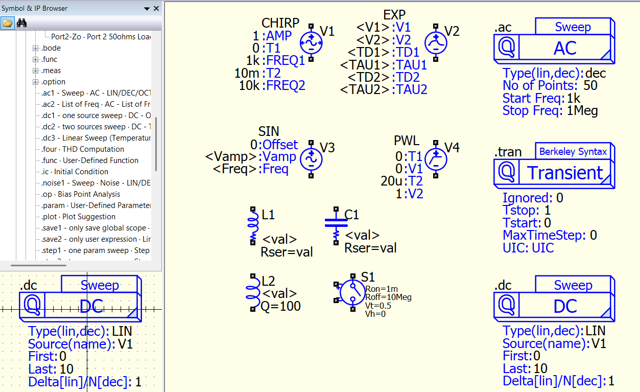

You frequently see updates in Qspice, and new instance parameters can be made available at any time. The approach of “Add Attribute” as instance parameters could make things easier when new features are delivered. It is also visible in schematic level how you setup a device. Unlike LTspice, you can simply don’t know what Rser is actually set for a capacitor from its schematic. It is quite clear that in multiple videos and discussions, Mike has expressed that he intentionally removed the pop-up menu. For advanced users, we see the disadvantages of the pop-up menu, but this may not be as clear for infrequent users.
However, infrequent users make up the majority. In my personal opinion, a custom symbol that looks like Advanced Design System (ADS) or QUCS could be beneficial. This is the closest thing I can think of to having more visual and easy-to-set-up symbols within the current Qspice infrastructure.
In the symbol of the inductance L2 Q=100, you should add FREQUENCY=. After all, the quality factor Q changes with a change in frequency.
I made that one with frequency invisible, as I considered that QUCS with this symbol and default freq by 100MHz.
But I think I will have another one with frequency visible.
