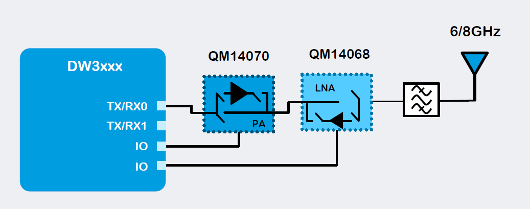

Hello, we are designing an UWB application using DW1000 and have the need to use both the QM14068 and QM14070. Since both ICs have an amplifying and bypass mode, could they be used together in series without the need for extra RF switches separating the RF paths?
Yes, they can be used in series as shown here:
