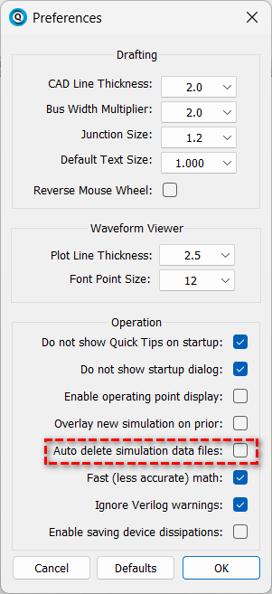

Disabling Auto delete simulation data files in the preferences will keep the .qraw file.

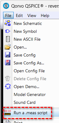

Open the .qraw file from File Explorer (double click), and in the waveform viewer, File > Run a .meas script.
