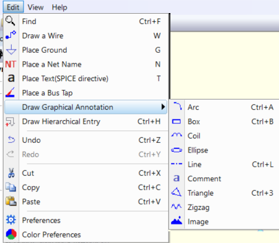

Is this what you are looking for?
Maybe I’m not fully understanding the question.
Len
PS: Just wiped the dust off my copy of LTSpice.
It does not appear that QSpice has a reference designator re-annotation feature.
However, it does warn you which reference designators are in conflict. Also, it is pretty easy to change reference designators in QSpice compared to LTSpice.
