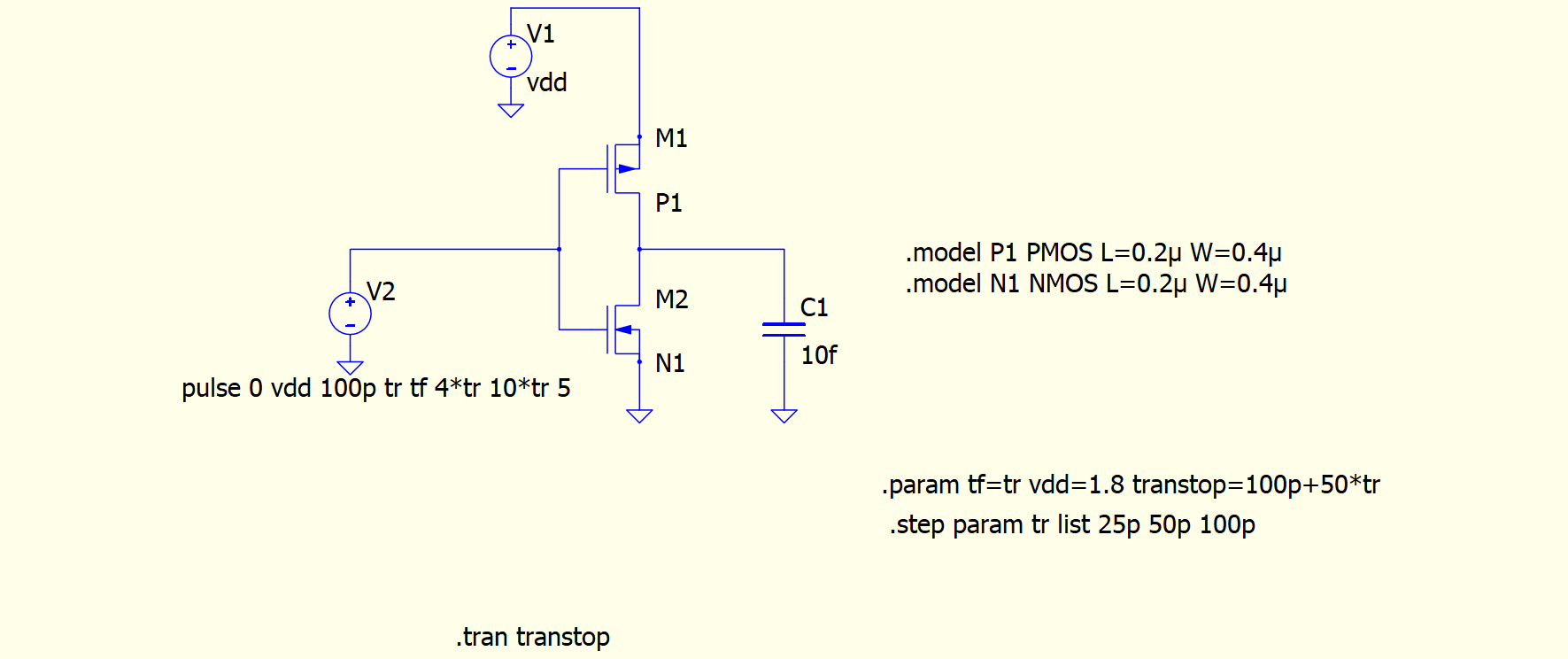

@ivan1 It is uncertain what exact problem @SJayanth encountered, the model he called is pfet_01v8 and nfet_01v8, and they should come from a .model which is not in Qspice standard library. Without his schematic to replicate his exact issue, it just don’t have enough information to troubleshoot.
Back to your proposal, actually, L and W is NOT necessary only with .model statement.

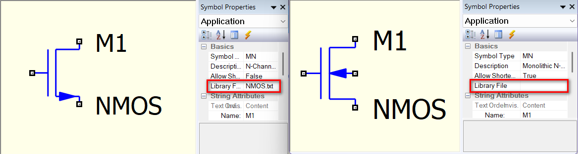

The reason that .model seems required when using the 4-pins NMOS and PMOS native symbol is that, Qspice in default doesn’t include standard library file NMOS.txt or PMOS.txt in its 4-pins symbol, but only 3-pins symbol. I created NMOS and PMOS symbol with substrate to source or with body diode and with NMOS.txt / PMOS.txt included in its library file field, and therefore this problem not bothering me.

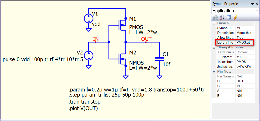

Now, missing .lib PMOS.txt
is where the problem lies in your schematic setup of why L and W cannot work as instance parameters. Qspice assume M-device with .model NMOS NMOS
, and if M1 PMOS doesn’t link with a library or .model that to define it as a PMOS, it return error to you. So, the solution is to add PMOS.txt (where it contains a .model PMOS PMOS
in its library) into library file field, or add .lib PMOS.txt
or .model PMOS PMOS
into schematic.
If in the first step, you are using 3-pin native PMOS/NMOS model, you won’t encounter problem in adding L and W as instance parameters.
Here is an example that L and W put into instance parameters as similar to @SJayanth schematic. However, what he encountered may be a different story.
mos (add library).qsch (5.3 KB)
