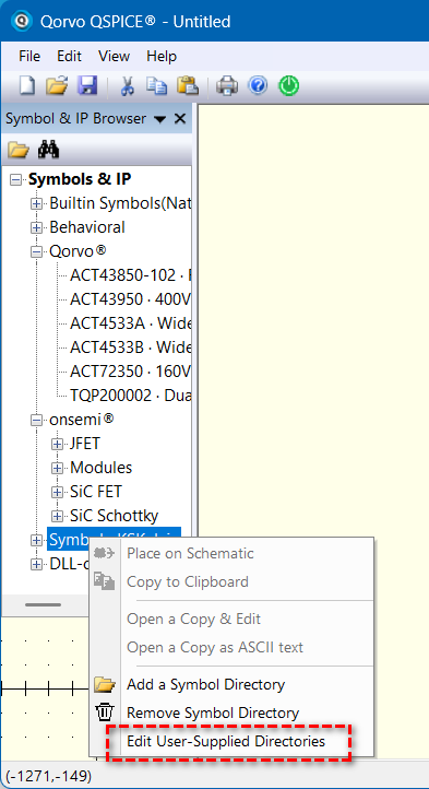

I don’t think so… but there is a trick I normally use to refresh the Symbol & IP Browser. Right-click anywhere in the Symbol & IP Browser > Edit User-Supplied Directories → OK. Do nothing in Edit User-Supplied Directories, just press OK and it will refresh the Symbol & IP Browser.

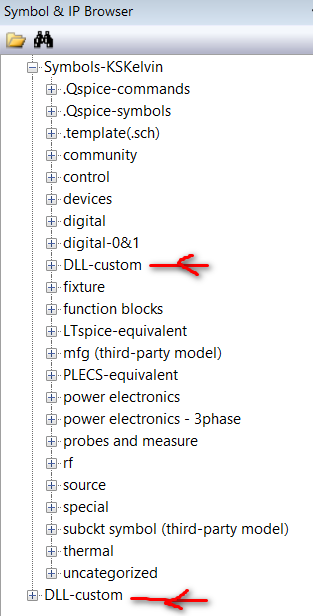

DLL? The directory that contains that .dll must be individually added to the Symbol & IP Browser.
For example, my custom library contains a custom DLL symbol directory, but to use it, that specific directory needs to be added. In short, for a DLL symbol pulled into a schematic, the DLL search is based on the root path in .libpath.
