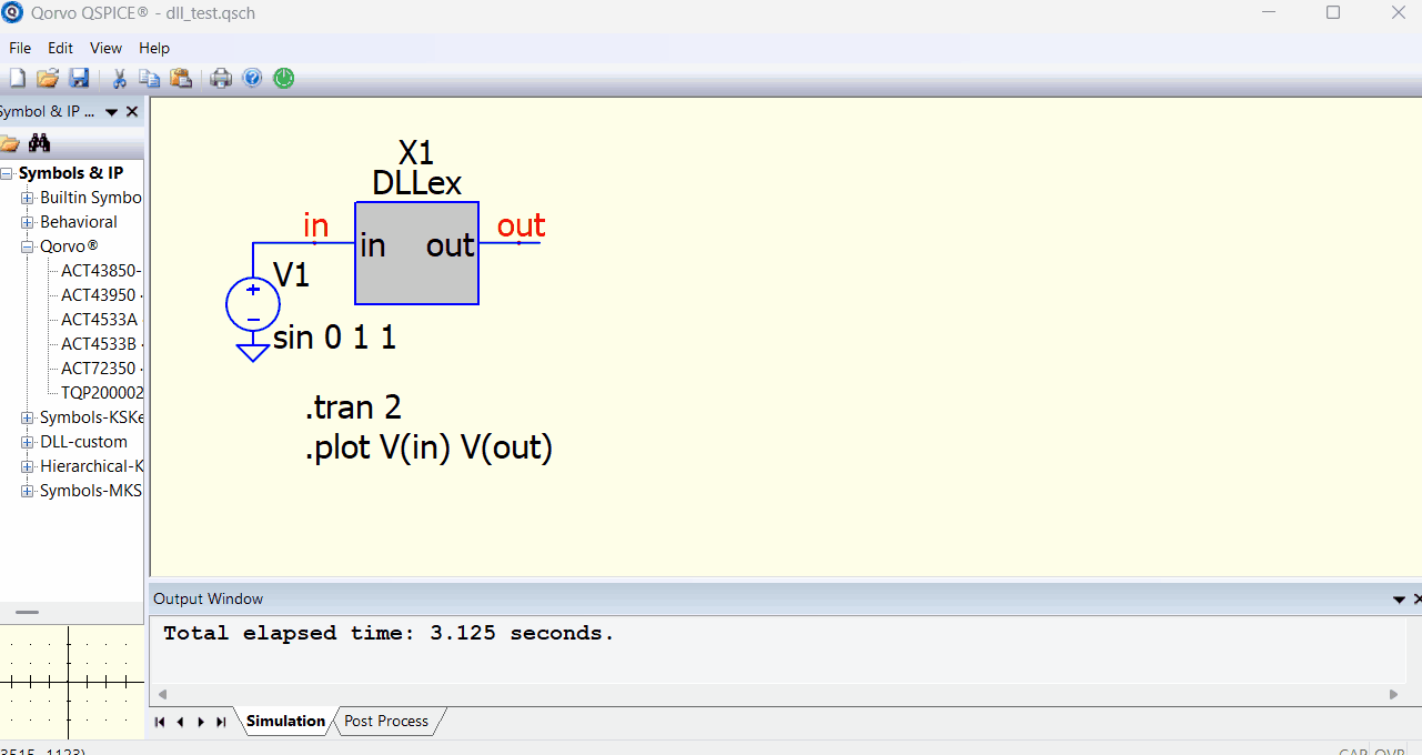

Download these two files and check if you can execute them.
From your description, it seems that the reason your simulation cannot run is related to an incomplete circuit (a floating node where something is not connected), rather than a DLL issue.
dll_test.qsch (1.4 KB) | dllex.cpp (1.4 KB)
