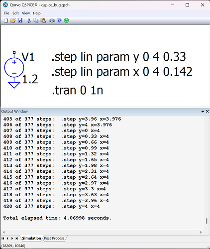

This seems to be a minor bug, in displaying the total number steps, in parametric sweeps, in very particular cases. Here’s a example:

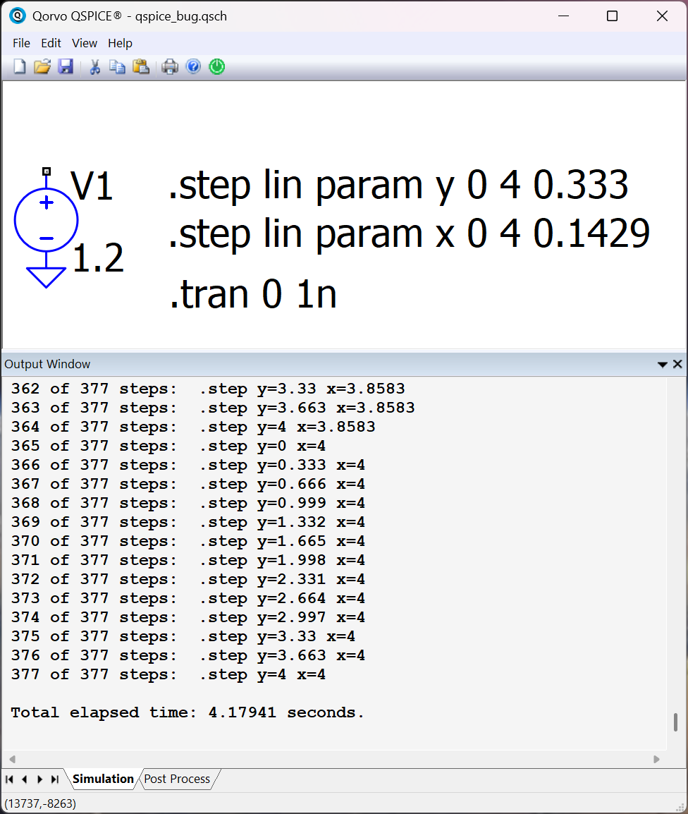

It can get it right if more accurate step size:

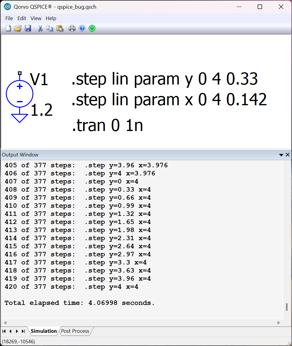

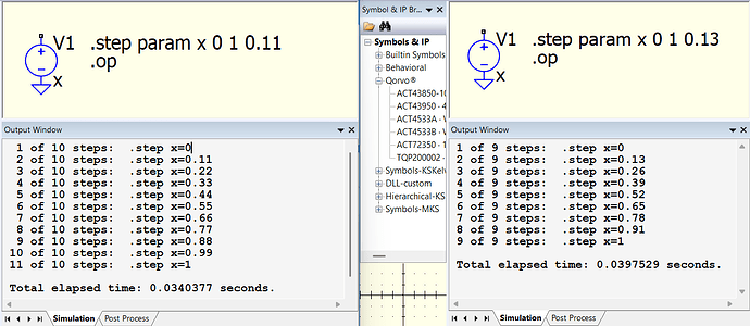

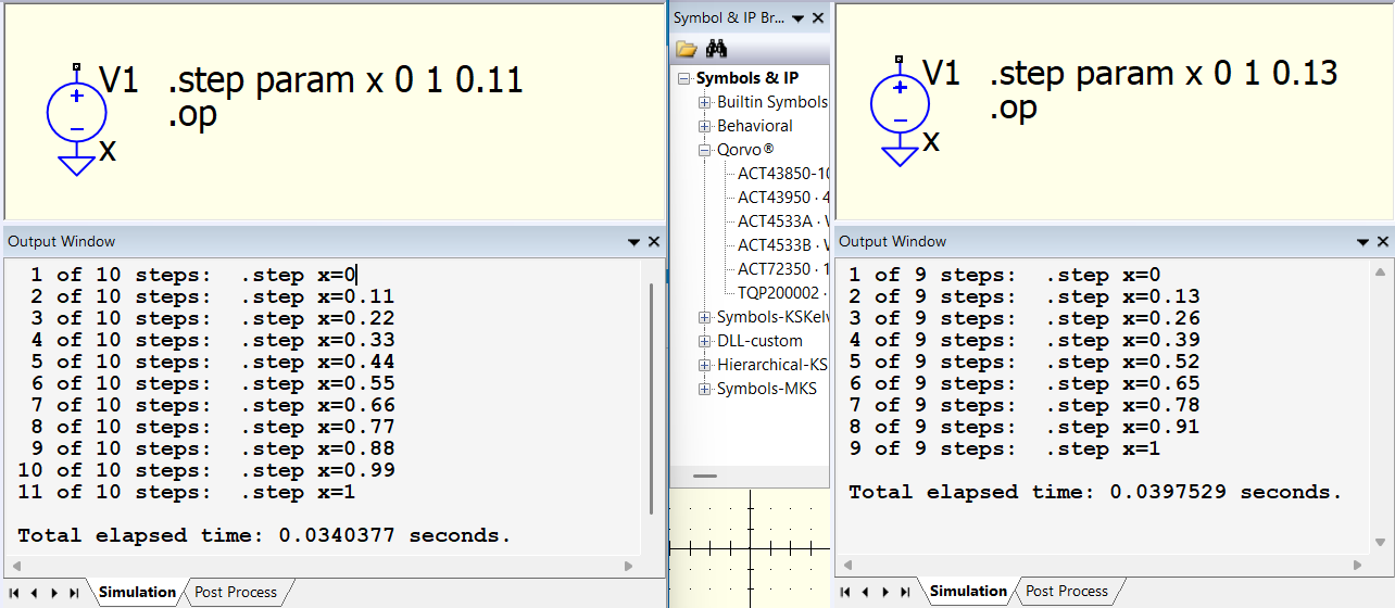

I guess this is this reason. To calculate number of step, we normally do this
steps = (max - min)/delta+1
.step param x 0 1 0.11 : steps = (1-0)/0.11+1 = 10.09 , round off is 10, round up is 11
.step param x 0 1 0.13 : steps = (1-0)/0.13+1 = 8.69, round off is 9, round up is 9.
possibly the total step is display with round off instead of round up.
